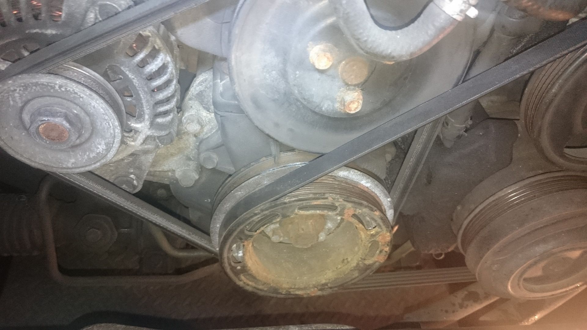

So that brings us up to date - it looks like the area around the sump is quite wet, I have taken loads of photos in the hope someone can maybe help me diagnose where to go next. I know it's next to impossible over the web but thought i've got nothing to lose!
Looking up at crank pulley from underneath
Crank pulley from above
Drips from both sides of the sump rear?

Two possibilities.
The main oil seal at the front of the crankshaft but maybe no.
The main rear oil seal between the back of the crankshaft and the flywheel.
Lets hope it is something easier.

Postby 71NotOut » Mon Mar 14, 2016 8:19 pm
OK so progress, of sorts...
Everything has been cleaned down, I have more space after removing all the aircon gubbings, and during assembly, I have noticed the oil leak continues to appear, even when the engine has not been turned over.
This is where the drip is coming from now:
Looks like it is weeping from the little drain hole in the gearbox casing:
I take it that points towards the crank rear oil seal?

Postby drumtochty » Mon Mar 14, 2016 9:11 pm
You are getting no younger so while it is possible to take the gearbox out with the kit you have, that's a young man's job not for a gent of your slightly older years!
Therefore unless you can get two thirty year olds to do it, no get it down on a ramp.
The clutch is around £100 for a kit and includes the pressure plate, friction disc, release bearing, the spigot bearing £9 plus you need the rear oil seal £12 to £26 depending on Mazda or non Mazda.
There is no need to do the front oil seal unless it is leaking.

Postby drumtochty » Mon Mar 14, 2016 9:23 pm
There is a half moon seal between the rear of the sump and the block, I guess it may be that but I would assume the rear main seal.
