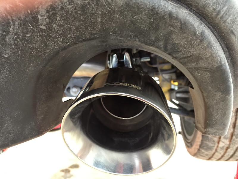

Thanks to Eddie today and the Drumtochty fettling facility we went from this;
to this;
That standard box is massive! Definitely grown since I did my NC1 as this one wouldn't fit in the boot, it's 'hidden' at Drumtochty until it can be recovered.
Some other shots today, car is sporting the grunge look just now :)

Fitted the Sherrif's Cobra Road Box today.
One of the outlet pipes was 90mm long and the other was 140mm long that confused me.
The two back boxes side by side.

Installed a Cobra Exhaust today on Larry's car as well as doing the brakes for his European trip next month.
Both lower slider pins on the front brakes were seized and the offside one took ages to free up.
We had a problem on this one as the input flange is nearer to the silencer body than the road types and the supplied M10 x30mm bolts were too long on one side only. I had some M10 x 25 bolts and fitting one of those sorted it.
The silencer was a different design to the last two I installed, they were road types this one is a race type but it did not sound much louder.
Here is a an installed picture.Image
